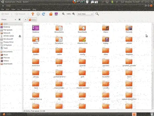

These screenshots are from a relatively mild occurrence, which happened after the second hibernation I took that session. The first one worked great, though I used the wireless card and Firefox heavily between the two hibernation attempts.
Take a look at what happened when I opened my home directory in Nautilus and scrolled it:
