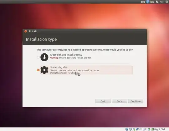

When you get to the part of installation where it asks you to select a hard disk to install ubuntu on and select something else.

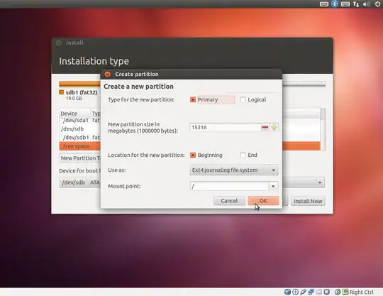

Select your smaller ssd drive and create a new partion from the empty space on that disk (it won't actually look exactly like in the picture since it's a virtual box)

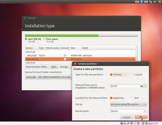

Now select your hdd and make a new partition as big as you want your data partition to be (probably not too big cause windows needs a lot). enter image description here

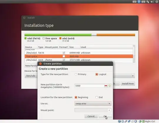

Finally on your hdd make a swap partition using 4 or 5 gigabyte enter image description here
