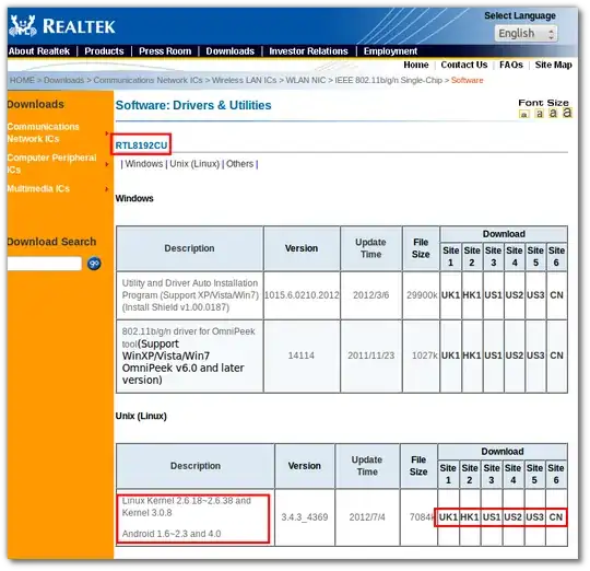

A. Downloading, compiling and installing the latest drivers for the USB-N13:
Try installing the latest driver from Realtek, released on July 4, 2012:
  1. The first step to troubleshoot your problem is to install the latest Linux drivers from the chipset manufacturer, Realtek.

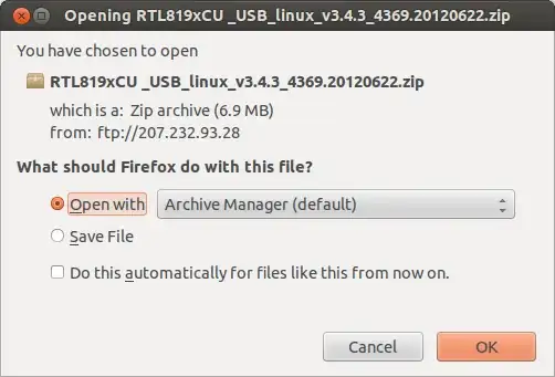

    • Go with the "Open With..." option given when you click on the download:

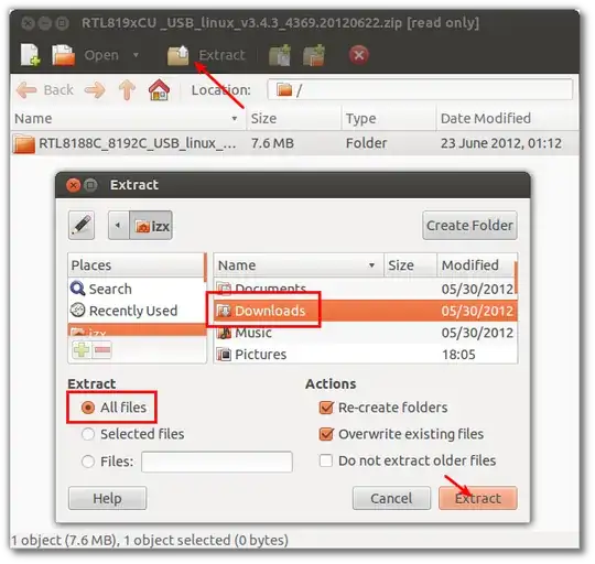

    • Once the downloaded zip opens in Archive Manager, click the Extract button on top, select All Files, select your Downloads folder, and click on Extract as shown below:
