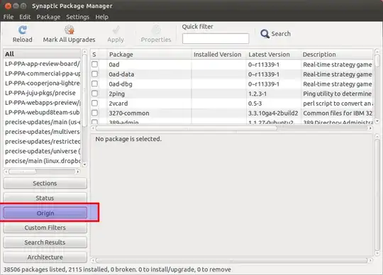

If a repository is leaving junk around you don't want, you can synaptic Install synaptic and click the Origin button:
Then click on the filter on the left that shows the repository, then you can select them and remove them from there. If you've already removed the repository the packages might be listed under "Local".
