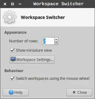

Since one of the comments above suggested that this feature was removed I searched through the settings and found a way without doing it manually. I am currently using Ubuntu 16.04.4LTS .
With a Rightclick on the the Workspace Switcher in one of the panels (see screenshot below) you can open the respective contex menu. From there you can choose Properties. The window is shown in the second screenshot below. Here you can choose a number of rows to be used for the
workspaces. The number of workspaces will then be distributed from top to bottom.
