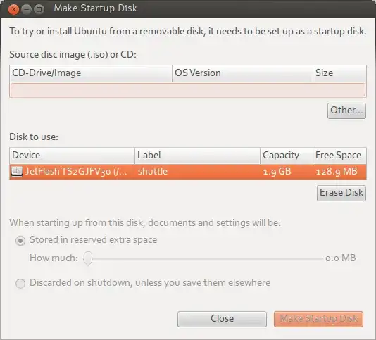

Hit Super(Windows Button) type in the following
Put in the USB Drive, Erase the disk, key in the location of the Ubuntu ISO Image

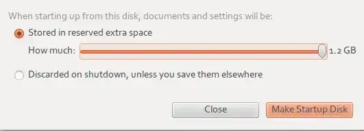

This is something that u should try >> Stored In Reserved Extra Space, Increase it to a few Gigs, depending on how much space u have to spare.

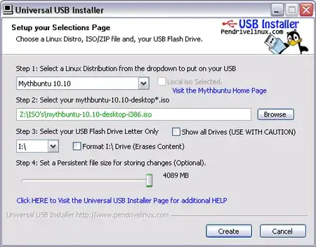

If u want to do this from Windows, make use an application called Universal USB Installer.
Reserve some space to store ur files.
