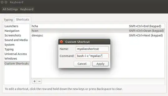

Yes, you can. You just need to ask the command for an interactive shell.
Let's say your alias is:
alias myalias='some cool command here'
Your shortcut command must be:
bash -i -c "myalias"
screenshot of setting up alias in keyboard settings
