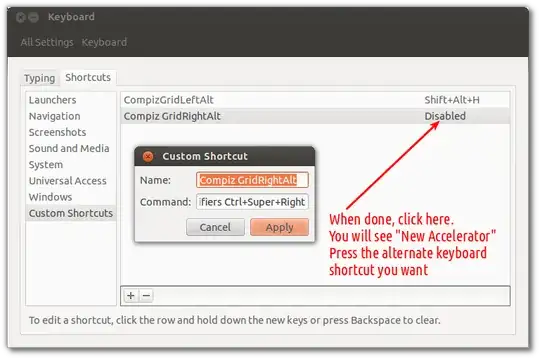

One way to do it is simply map the custom secondary keyboard shortcut to the primary (Compiz) shortcut using xdotool.
  1. xdotool is a small command-line utility which allows automation of keyboard and mouse clicks/movements; install it with sudo apt-get install xdotool
  2. We'll assume here that the default shortcuts for Grid Left/Right are as below: (Ctrl+Super+Left/Right):
  3. Open Settings...Keyboard, and go to the Shortcuts tab. Click + to create a custom shortcut, naming it say Compiz GridRightAlt, and setting the "Command" field to:
    xdotool key --clearmodifiers Ctrl+Super+Right
    Click Apply. The right-column will say Disabled, click on it and you'll see "New Accelerator": press your shortcut key combo, e.g. Shift+Alt+L.
    • Repeat the steps for the left Compiz GridLeftAlt, setting the command to:
    xdotool key --clearmodifiers Ctrl+Super+Left
    and the shortcut keycombo to Shift+Alt+H.
Close the Keyboard settings and that's it!
