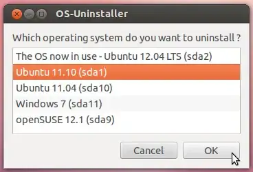

The program will install and start, it will look something like this:
Just select Windows Vista in the menu and the click ok.

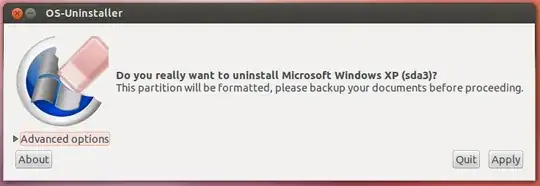

Click Apply The program will do the rest.
