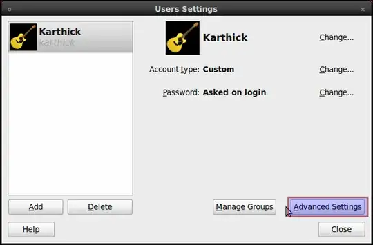

  • Goto System>>Administration>>Users and Groups
alt text
  • Click Advanced Settings and goto Advanced Tab there in the bottom you will see your user id.
  • Change it and click ok.
    alt text
karthick87
