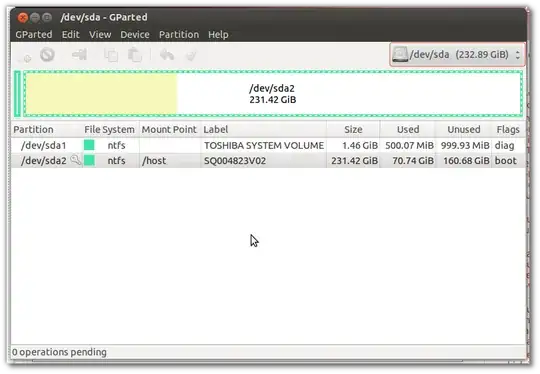

So I am at GParted, and he says to delete the Windows Partition. I have a feeling the 2nd one is the Windows Partition, but it's locked. Here's the first picture:
The second Partition I can't delete, it is just gray over the delete button.

Be very sure you are not using Wubi (installed Ubuntu from Windows) since your NTFS partition is called /host!! *And that you are on a Live-CD/USB!*
Both partitions are NTFS; the first one is a "diagnostic" partition from Toshiba, the second one is Windows. You may have to right-click and Unmount the partition in gray before GParted will let you delete it; if there is no Unmount option or you try unmounting and it fails, you are probably using Wubi!

The second one is indeed your Windows partition. You will have to unmount this partition first by right-clicking and choosing "Unmount".

Edit: it seems like you are running a Wubi install, since your Windows partition is mounted on /host. In this case, the information above is irrelevant and you will have to reinstall Ubuntu "the real way" in order to achieve what you want.

As I see your primary partition is /dev/sda2 with the ntfs filesystem and your system is booting on this partition , probably it's "windows" that you're looking for. Although /dev/sda1 is a partition for diagnostics or recovery but there is no mount point on.
To delete a partition : try to login as sudo and launch "cfdisk" to manage your partitions , then unmount your mount point on your last partition .
As you don't have an ext2/3/4 partition - your Ubuntu installation is a Wubi installation which uses a virtual disk. If you want a completely native Ubuntu installation you need a separate partition on disk for Ubuntu.
