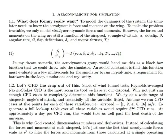

Full demo
Here's a full demo of an online LaTeX .tex file you can process. It works very well.
We will convert this LaTeX file to a PDF: https://github.com/google/makani/blob/master/documentation/control/aero/aero_spec.tex. This is from the Google "Makani" kite/tethered aircraft wind power generation project.
# download this LaTeX file
wget https://raw.githubusercontent.com/google/makani/master/documentation/control/aero/aero_spec.tex
# convert it to a PDF
pdflatex aero_spec.tex
Now, manually open up aero_spec.pdf in your favorite PDF viewer, such as Foxit Reader, which allows you to highlight, underline, write notes, etc, in the PDF.
Here's what the generated PDF looks like:
