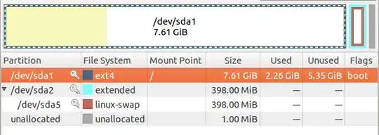

  • The default, i.e. what the ubuntu installer chooses for you if you select erase entire drive is heavily tested by millions of users. It will work very well.
The default file system in Ubuntu currently is ext4. This is what that partitioning looks like on one of my virtual machines: alt text
This works extremely well
