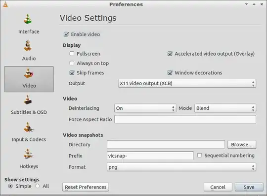

My solution was to go to Tools > Preferences in VLC and, in the Video tab:
  • Check the box for Enable video (if it's unchecked).
  • Check the box for Window decorations (if it's unchecked).
  • Set the Output drop-down menu to X11 video output (XCB).
Then Save your changes. That may fix the problem.
