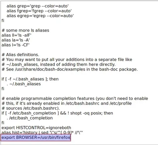

  • Alternate way is to add the following line export BROWSER=/usr/bin/firefox to your ~/.bashrc
  • Add the above line in the last,
    enter code here

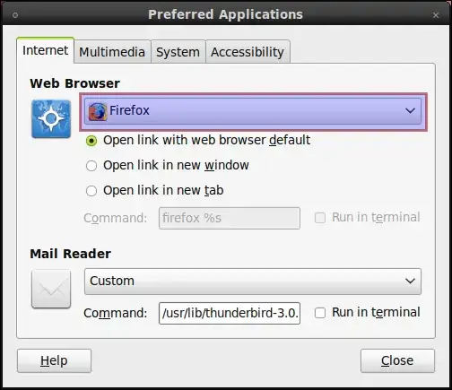

Alternative GUI Method:
  • You can also set the default browser in Gnome applications,type the following in terminal and press Enter gnome-default-applications-properties
  • It will Open a Window.Now you can choose your preferred browser to set it default. alt text

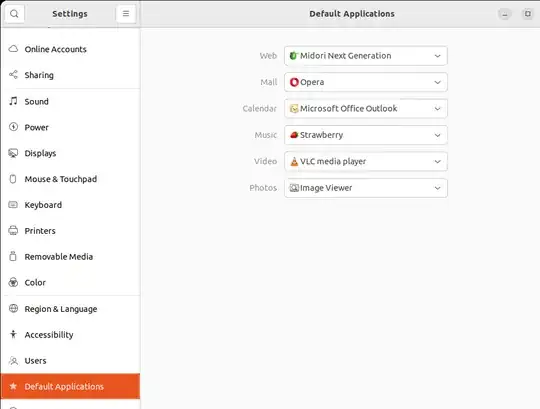

first of all, I use Ubuntu 22.04 and wanted to set Midori as my default browser, but this was even not listed in the list of browsers.
Reading a bit discovered that the configuration file to define default browser was:
~/.config/mimeapps.list
Then as I have several browsers I discovered that In order to add to the list of browsers I needed to find which was the *.desktop Application Meta Description of Midori, those files *.desktop are located in several places of ubuntu but mainly on:
/usr/share/applications
With this information and after comparing what changes in the file after setting default browser in ubuntu/settings the following images show how I finally set midori as default browser:
  1. Find the name *.desktop of midori, in my case was midori-ng.desktop
  2. Edit the file ~/.config/mimeapps.list
  3. Add entries of midori-ng.desktop in the list of available brosers.
  4. In my case midori-ng.desktop was but defined, because didn't pass the parameter or arguments to the app so I couldn't for example open a link that was in a pdf. So I had to edit the midori-ng.desktop file to set the parameter as midori %u.
where to put midori to be in the combobox of default browsers Added Midori in the combobox of default browsers. added midori as default browser Added Midori as default browser Edit midori-ng.dekstop Edit midori-ng.dekstop Edit midori-ng.dekstop Added missing handler of argument or parameter %u Midori Now Appears Listed in Settings Midori Now Appears Listed In Settings
