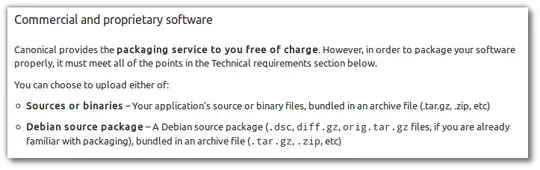

Michael Nelson's answer should be considered, ahem, "canonical", but since I had a draft almost done, here's my two cents :)
I think the Dev Portal's policy on how to upload proprietary packages pretty much explains why you have this problem and what your alternatives are:
Let's break it down:
  1. Sources or binaries
    • It appears you want to upload multiple binaries. Generally, proprietary binary apps are either statically linked, or bundle their necessary dependencies with relative paths, so that nothing extra needs to be installed via apt-get, except perhaps ia32-libs.
    • It would be up to you to make sure that such a binary runs on Ubuntu 11.04/11.10/12.04 (whichever you're targeting), without failing on any platform; AFAIK the core requirement is that the libc used to compile your app/libraries be backwards-compatible with the oldest-possible kernel you wish to target; I believe anything that is Lucid or newer is fine with the current libc 2.15 on Precise.
    • I don't know how extensive Canonical's packaging services to commercial devs are if you submit a non-debianized source, but I assume it would have to be compile-able to something similar to the above "universal" binary.
  2. Debian Source Package:
    • If you go with this option, all you need to do is (a) ensure that any dependencies are available in the repos for the oldest release you want to target, and that (b) your app does not use any new-fangled functions/API/ABI in those dependencies such that it works on say, 12.04 but fails on 11.04.
    • In this case, I believe Canonical/Soyuz (the build system) will take care of creating multiple packages for each release.
  3. Get a human involved - pack all your different binaries into a giant tarball and contact noodles775 ;p
