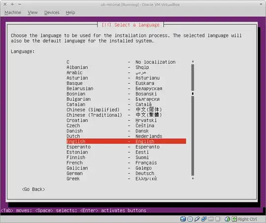

Boot with the livecd, once you have got past the start screen you will get options for language, location and keyboard layouts.
The installer will then detect hardware and ask for network configurations. Choose a mirror and select and appropriate archive for your locale.

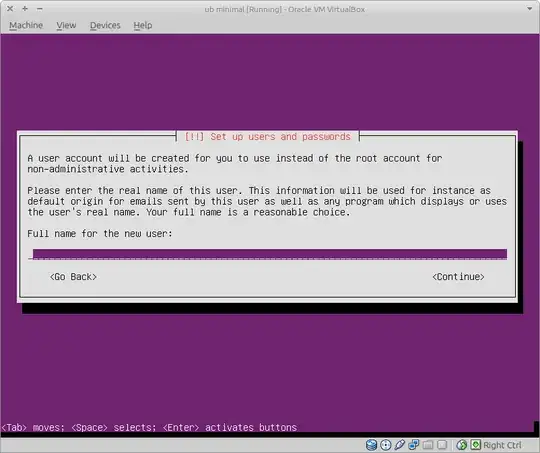

After more configuration you will be able to add users and passwords, enable encryption if required.

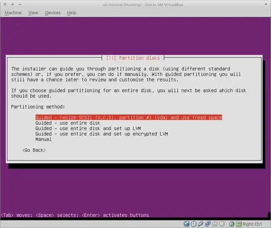

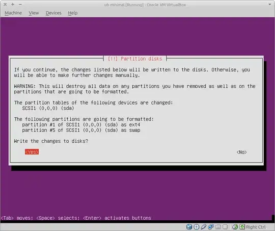

Next setup your partitions as required

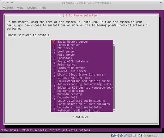

The installer now installs the base system, you will then be shown a software selection screen - I picked manual package selection, but then quit from aptitude when it was available. Wishing to install my packages later. You can if you wish select your packages here if you wish.

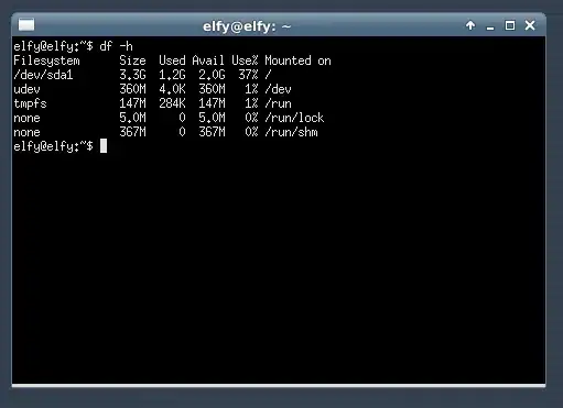

This install used 1.2Gb.
