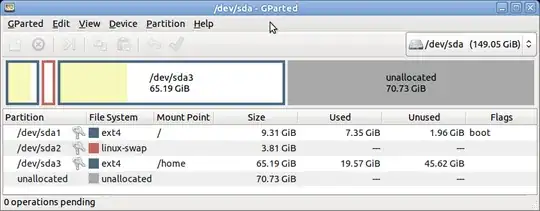

Im starting to be a bit short on / partition. I have a lot of free space on my disk.
I would like to mount /usr and /opt on new partitions without loosing the data. But I have no idea of how doing this.

There's two ways of doing that which I'm aware of:
  • The first would be to use an Ubuntu live CD or USB, boot your laptop from that and using GParted in the OS booted from that CD/USB unmount your /dev/sda3 partition so that you can resize it to take up the whole of your hard drive space.
  • The second would be to copy and paste all the data you need onto an external hard drive, then using an Ubuntu install such as a live CD/USB and reinstall Ubuntu 11.04 (or 11.10 or 12.04 if you feel like upgrading) and merge the partitions so you fill up the whole of your hard drive space.
As Ubuntu works quite well when it comes to partitioning both of these options are safe, however as always when modifying disk partitions it is always very recommened to back up beforehand that way even in the case even if something happens to go wrong, you're sure not to have lost any data.
Hope my answer was of some help, feel free to comment to ask me for more details if you're unsure of anything I've explained above as I might not have explained everything thoroughly enough. [Also I'm assuming when you said you wanted to create new partitions that you meant that you want to be able to use all the free disk space you have at the end of your hard drive, rather than create separate partitions for /usr and /opt as that would be quite a hassle to access afterwards]
