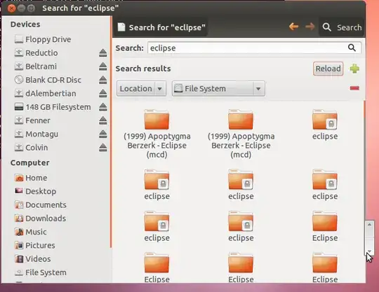

  • I don't know of a way to use the Unity Dash to tell you the location of a program in an accessible way. But you can accomplish this graphically with Nautilus, the graphical file browser.
    1. Open a Nautilus window and press Ctrl+F (or click Go > Search for Files...).
    2. Type in what you're searching for (in this case, eclipse) and press Enter.
    3. By default this will search just in the folder that is open in this particular Nautilus window. But you can change that. After searching, change the Location to Filesystem (or to wherever you want to search, you could even specify the custom search location /usr) and click Reload.
    Search of file system for eclipse, in Nautilus
    This is how you search for files on your system in general (i.e., not just those provided by Ubuntu packages), with the ability to get detailed information about them.
