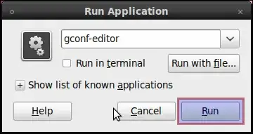

Press Alt+F2 and type gconf-editor and click Run.

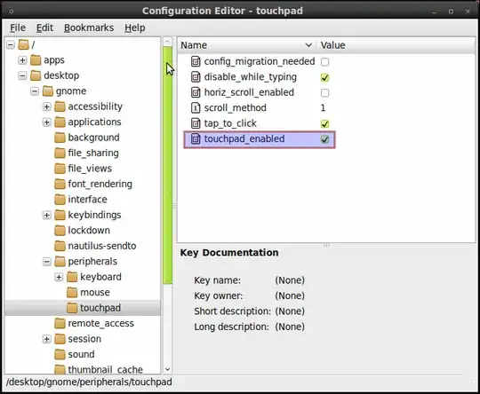

Navigate to desktop>gnome>peripherals>touchpad,in the right panel uncheck the entry touchpad_enabled.
alt text
Now your touchpad will be disabled.
