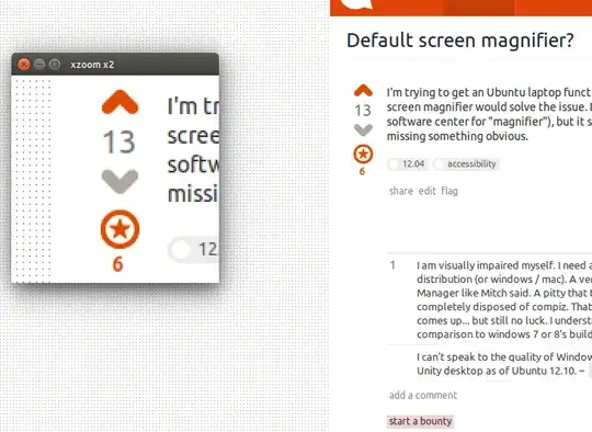

xzoom
I found a simple solution that is working very well for me. I installed xzoom from the default repositories.
The usage is very simple, and exactly what I wanted:
  • start xzoom.
  • place the window where it does not disturb you.
  • "drag" your mouse cursor from within the window to the spot of the screen you want to magnify.
xzoom example

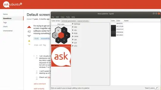

Another alternative I found is gpick, which is also available natively on Ubunutu. It works by showing a zoomed in window in the left area -- and the zoomed area follows the mouse cursor:
Compared to xzoom it seems to lack the possibility to scale and resize the zoom window, but offers the additional feature of picking pixel colors -- which sometimes is a related use case for me.

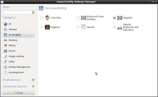

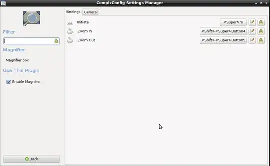

Unity (until Ubuntu 17.04)
CompizConfig Settings Manager
To use magnifier in Ubuntu, you can do so by using CompizConfig Settings Manager. If you don't have it installed, you can do so from the Ubuntu Software Center.
Or, just press Ctrl+Alt+T on your keyboard to open Terminal. When it opens, run the command below.
sudo apt-get install compizconfig-settings-manager
You can also use Synaptic Package Manager
Once you invoke the program, look under Accessibility for magnifier, and click on it to configure it.
Or you can try Virtual Magnifying Glass 3.5

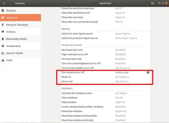

In Ubuntu 18.04 you don't need to install anything.
  • Go to Settings -> Keyboard by using the Applications icon enter image description here at the bottom-left end of your screen.
  • From there, scroll down to the Universal Access section.
  • Then setup the 3 keyboard shortcuts you wish to use for the magnifer:
    • turn on/off zoom, zoom in, and zoom out.
Visually: keyboard shortcut screen for zooming/magnifier

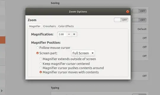

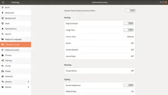

USE DEFAULT OPTION. No need to install anything extra In UBUNTU 18.04 LTS,. It is lot more easier than ever.
Magnify a screen area
Magnifying the screen is different than just enlarging the text size. This feature is like having a magnifying glass, allowing you to move around by zooming in on parts of the screen.
Step 1: Open the Activities overview and start typing Universal Access.
See this screenshot 1
Step 2: Click on Universal Access to open the panel.
Step 3: Press on Zoom in the Seeing section.
See this screenshot 2
Step 4: Switch Zoom to ON in the top-right corner of the Zoom Options window.
See this screenshot 3
You can now move around the screen area. By moving your mouse to the edges of the screen, you will move the magnified area in different directions, allowing you to view your area of choice.
You can quickly turn zoom on and off by clicking the accessibility icon on the top bar and selecting Zoom.
You can change the magnification factor, the mouse tracking, and the position of the magnified view on the screen. Adjust these in the Magnifier tab of the Zoom Options window.
Reference: link

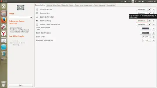

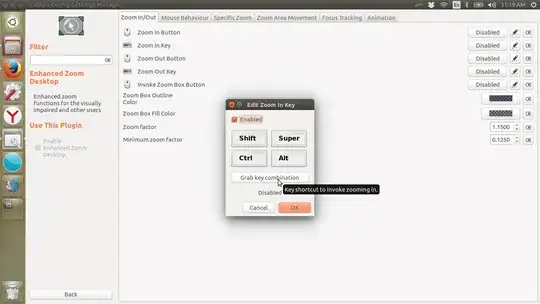

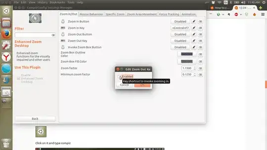

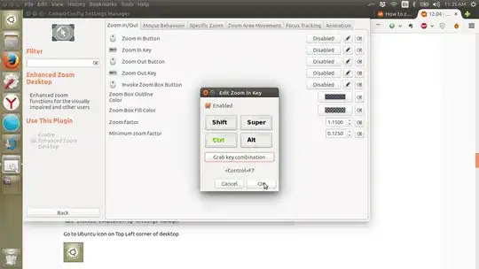

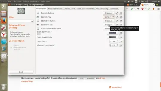

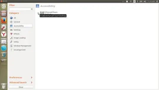

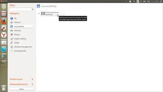

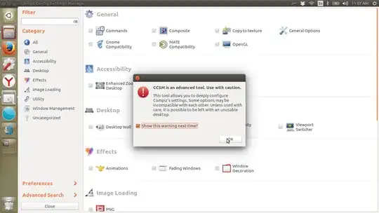

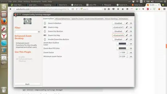

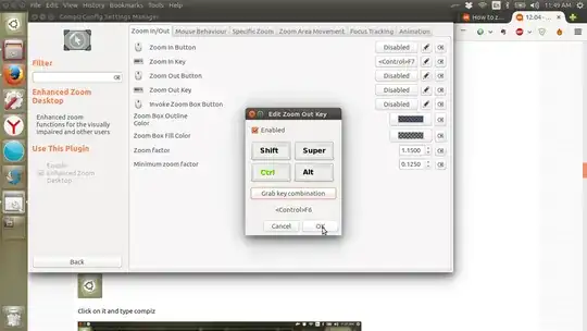

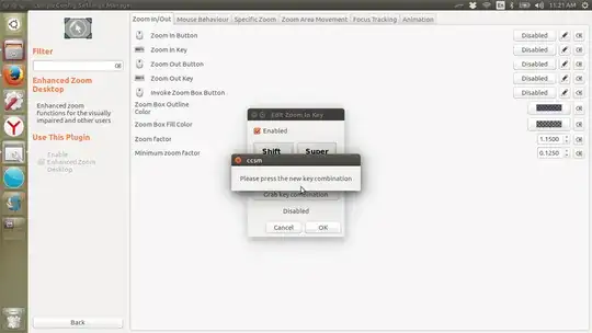

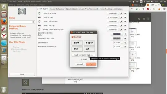

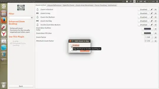

For Ubuntu 16.04
Press Ctrl + Alt + T
The terminal opens, type
sudo apt install compizconfig-settings-manager
Go to Ubuntu icon on Top Left corner of desktop
Click on it and type compiz
Click on the compiz icon that appers in the window
The following window opens:
Click on OK
Go to Accebility --> Enhanced Zoom Desktop --> Tick the box
Click on Enhanced Zoom Desktop

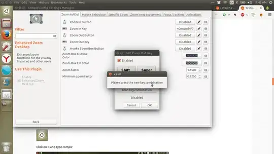

Click on Zoom In Key --> Disabled
Tick the box Enabled
Click on Grab Key Combination
Press together
Ctrl + F7
Click on OK
Click on Zoom Out Key --> Disabled
Tick on the box Enabled
Press together
Ctrl + F6
Click on OK
Close the window
From now on
to Zoom In press
Ctrl + F7
and to Zoom Out press
Ctrl + F6
