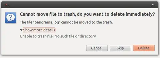

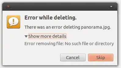

How can I delete a file that is there but the system says is not there?

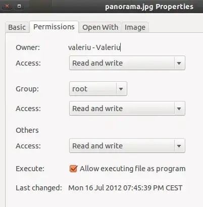

Permissions tab - tried changing it, but it would reset itself automatically This is what happens when I click "Delete"

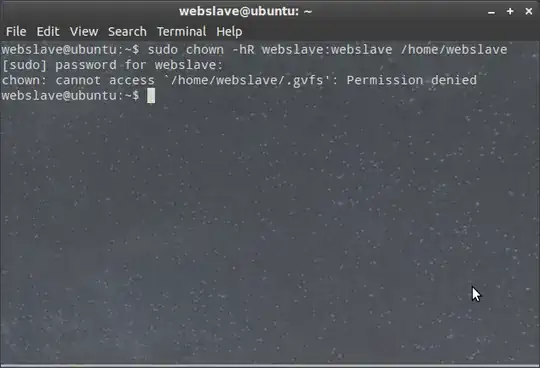

Looking at your screenshots I see you have the group set as root. I'd try using chown and see if it fixes the problem.
sudo chown -hR [username]:[username] /home/[username]
Replacing [username] with your username.
You'll get a couple errors.
