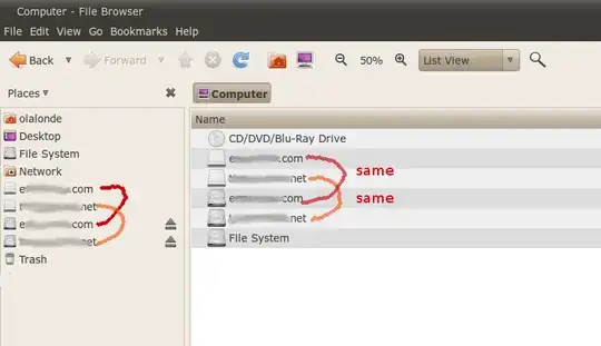

Edit 2: Here's a screenshot of my Nautilus showing the duplicate servers. By the way, I just realized those have nothing to do with the "Places / Connect to Server..." feature: alt text

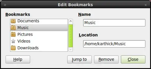

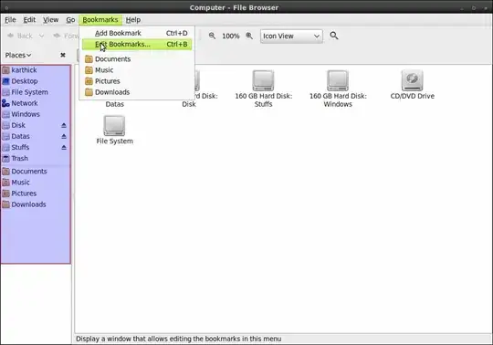

  • Open nautilus browser and in left you will see places menu.
  • Goto Bookmarks>>Edit Bookmarks
alt text Remove the Entry which you have twice, alt text
Or in terminal type the following,and remove the entry.
gedit ~/.gtk-bookmarks
Removing servers from the list:
  • You can remove the remote servers from the list by opening the Network folder from Places>>Network.
  • Right-click the server you want to remove and then clicking unmount volume.

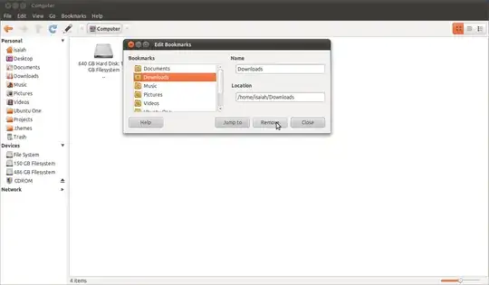

  1. Open up Nautilus: Places -> Home Folder (or any other bookmark listed there).
  2. Bookmarks -> Edit Bookmarks.
    alt text
You can also right-click the bookmarks on the side panel, and remove them that way.
