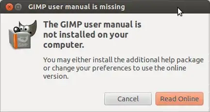

When try to open help, I get the message below. How do I install and configure the help for 2.8 on Ubuntu?
Dialog that says: "The GIMP user manual is not installed on your computer. You may either install the additional help package or change your preferences to use the online version". It has two buttons: "Cancel", and "Read Online".

Most likely, the PPA does not contain the required package for the documentation, or GIMP's documentation has not been made ready yet for 2.8.
In any case, try
apt-cache search gimp-help
and install the appropriate package for your language.

Use Synaptic package manager (System/Administration/Synaptic Package Manager) and search gimp help in the search box. Mark the package of your language for installation and click apply. Give password when required.
