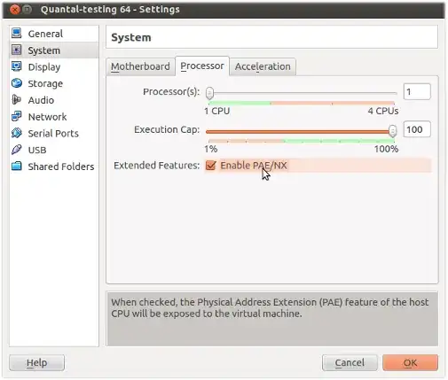

55
On VirtualBox Manager, open your virtual machine configuration then select System on the left side and open the Processor tab. Be sure that Enable PAE/NX is checked.
For commandline
VBoxManage modifyvm <VM_name> --pae on
