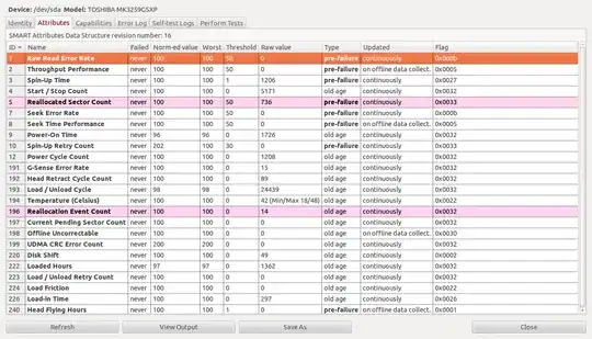

I am having exactly the same problem, https://answers.launchpad.net/ubuntu/+source/linux/+question/166624
ADDED INFO
smartctl 5.43 2012-06-05 r3561 [i686-linux-3.5.0-3-generic] (local build)
Copyright (C) 2002-12 by Bruce Allen, http://smartmontools.sourceforge.net
=== START OF INFORMATION SECTION ===
Model Family:     Toshiba 2.5" HDD MK..59GSXP (Adv. Format)
Device Model:     TOSHIBA MK3259GSXP
Serial Number:    61OJC86CT
LU WWN Device Id: 5 000039 353c09e33
Firmware Version: GN003J
User Capacity:    320,072,933,376 bytes [320 GB]
Sector Sizes:     512 bytes logical, 4096 bytes physical
Device is:        In smartctl database [for details use: -P show]
ATA Version is:   8
ATA Standard is:  Exact ATA specification draft version not indicated
Local Time is:    Sun Jul 15 00:36:16 2012 BDT
SMART support is: Available - device has SMART capability.
SMART support is: Enabled
=== START OF READ SMART DATA SECTION ===
SMART overall-health self-assessment test result: PASSED
General SMART Values:
Offline data collection status:  (0x00) Offline data collection activity
                    was never started.
                    Auto Offline Data Collection: Disabled.
Self-test execution status:      (   0) The previous self-test routine completed
                    without error or no self-test has ever
                    been run.
Total time to complete Offline
data collection:        (  120) seconds.
capabilities:            (0x5b) SMART execute Offline immediate.
                    Auto Offline data collection on/off support.
                    Suspend Offline collection upon new
                    command.
                    Offline surface scan supported.
                    Self-test supported.
                    No Conveyance Self-test supported.
                    Selective Self-test supported.
SMART capabilities:            (0x0003) Saves SMART data before entering
                    power-saving mode.
                    Supports SMART auto save timer.
Error logging capability:        (0x01) Error logging supported.
                    General Purpose Logging supported.
Short self-test routine
recommended polling time:    (   2) minutes.
Extended self-test routine
recommended polling time:    ( 103) minutes.
SCT capabilities:          (0x003d) SCT Status supported.
                    SCT Error Recovery Control supported.
                    SCT Feature Control supported.
                    SCT Data Table supported.
SMART Attributes Data Structure revision number: 16
Vendor Specific SMART Attributes with Thresholds:
ID# ATTRIBUTE_NAME          FLAG     VALUE WORST THRESH TYPE      UPDATED  WHEN_FAILED RAW_VALUE
  1 Raw_Read_Error_Rate     0x000b   100   100   050    Pre-fail  Always       -       0
  2 Throughput_Performance  0x0005   100   100   050    Pre-fail  Offline      -       0
  3 Spin_Up_Time            0x0027   100   100   001    Pre-fail  Always       -       1206
  4 Start_Stop_Count        0x0032   100   100   000    Old_age   Always       -       5171
  5 Reallocated_Sector_Ct   0x0033   100   100   050    Pre-fail  Always       -       736
  7 Seek_Error_Rate         0x000b   100   100   050    Pre-fail  Always       -       0
  8 Seek_Time_Performance   0x0005   100   100   050    Pre-fail  Offline      -       0
  9 Power_On_Hours          0x0032   096   096   000    Old_age   Always       -       1726
 10 Spin_Retry_Count        0x0033   202   100   030    Pre-fail  Always       -       0
 12 Power_Cycle_Count       0x0032   100   100   000    Old_age   Always       -       1208
191 G-Sense_Error_Rate      0x0032   100   100   000    Old_age   Always       -       15
192 Power-Off_Retract_Count 0x0032   100   100   000    Old_age   Always       -       89
193 Load_Cycle_Count        0x0032   098   098   000    Old_age   Always       -       24439
194 Temperature_Celsius     0x0022   100   100   000    Old_age   Always       -       42 (Min/Max 18/48)
196 Reallocated_Event_Count 0x0032   100   100   000    Old_age   Always       -       14
197 Current_Pending_Sector  0x0032   100   100   000    Old_age   Always       -       0
198 Offline_Uncorrectable   0x0030   100   100   000    Old_age   Offline      -       0
199 UDMA_CRC_Error_Count    0x0032   200   200   000    Old_age   Always       -       0
220 Disk_Shift              0x0002   100   100   000    Old_age   Always       -       49
222 Loaded_Hours            0x0032   097   097   000    Old_age   Always       -       1362
223 Load_Retry_Count        0x0032   100   100   000    Old_age   Always       -       0
224 Load_Friction           0x0022   100   100   000    Old_age   Always       -       0
226 Load-in_Time            0x0026   100   100   000    Old_age   Always       -       297
240 Head_Flying_Hours       0x0001   100   100   001    Pre-fail  Offline      -       0

Thanks for posting the Output,
The above results suggest that they have already crossed their Threshold values, it would be wise to take backup , and Replace it if is under Warranty period. Further pressing to get the desired performance may damage it.
Reallocated Sectors Count showing 736 , While primarily used as a metric of the life expectancy of the drive, this number also affects performance. As the count of reallocated sectors increases, the read/write speed tends to become worse because the drive head is forced to seek to the reserved area whenever a remap is accessed.
Spin Retry Count showing 202 It is the count of retry of spin start attempts. This attribute stores a total count of the spin start attempts to reach the fully operational speed (under the condition that the first attempt was unsuccessful). An increase of this attribute value is a sign of problems in the hard disk mechanical subsystem.
For further reading refer here and S.M.A.R.T. wiki
P.S: A low health value alone does not neccessary mean that the hard disk will surely die in the near future (to verify this, a complete (hardware) examination is required), but there is a real chance for failure.
atenz
  • 12,858
I consider any drive showing a non-zero value for Reallocated Sector Count or Reallocation Event Count to be a candidate for warranty replacement. Combined with the inability to detect the drive in SATA mode, I think you have a bad drive. If it is still under warranty, have the drive replaced.
Michael Hampton
  • 1,860
  • 16
  • 27
Replace the drive. Any drive that has bad sectors is doomed to fail some day.
