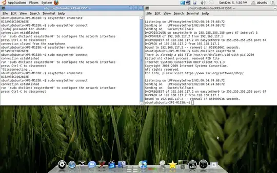

I posted yesterday regarding how to configure easytether on Ubuntu. I followed the steps and everything looks good from the terminal. But I am not able to connect to the Internet. Currently I am connected to a Wireless network, I tried disconnecting to it, in hope to connect to Internet using my phone but with no help. How do I make my notebook use my cell phone's connection. I have attached the snapshot from the terminal.
alt text

I checked this link and this one, a bit shorter and using easytether. it seems that everything you are doing is correct. Have you actually done what you need to do on your phone? i.e. gone into wireless settings and allow share network, etc.? You might need to look up if there is an extra setting with your model.
