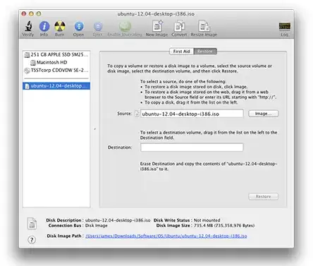

  • Drag and drop your .iso file to the left pane in Disk Utility. Now both the blank disc and the .iso should be listed.

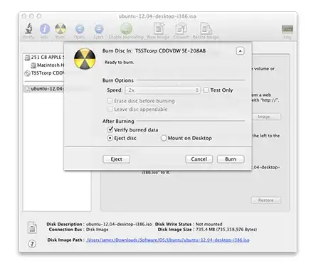

  • Select the .iso file, and click on the 'Burn' button in the toolbar.enter image description here
  • Ensure that the 'Verify burned data' checkbox is ticked (you may need to click on the disclosure triangle to see the checkbox).enter image description here
  • Click 'Burn'. The data will be burned and verified.
