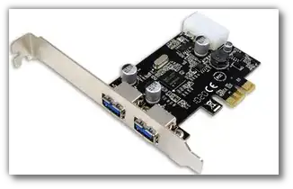

    • Logilink also makes a 2-port PCI-Express USB 3.0 card which uses the NEC USB 3.0 chipset that has excellent support in Linux/Ubuntu (it was the first USB 3.0 chipset to come out and the company played an important role in drafting the USB 3.0 standard).
    • I would certainly consider replacing your card with this one instead of messing about with mainline/beta kernels.

You can use NEC chipset, the 3rd generation D720201, and this PCIe to USB 3.0 card with 20pin connector.
