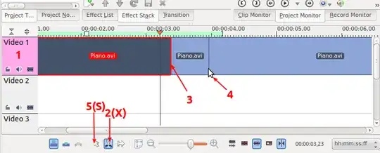

1. How to quickly mark a segment to delete:
  1. Make sure the video track is selected.
  2. Press X to switch to the Cut (Razor) Tool
  3. Click once in the timeline at the start point
  4. Click once at the end point
  5. Press S again to switch back to selection mode

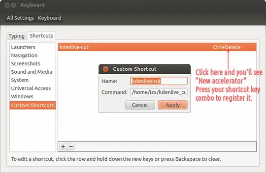

2. Use xdotool to automate delete/remove space with a single keyboard shortcut
  1. xdotool allows automation of keyboard and mouse clicks/movements; install it with sudo apt-get install xdotool
  2. Copy and paste the below to an sh file, say kdenlive_cut.sh in your home directory:
    #!/bin/bash
    DELAY=0.5 # delay in seconds between each action xdotool search --limit 1 -name Kdenlive > nul # activate only if kdenlive running if [ $? -eq 0 ] then xdotool click 1 && sleep $DELAY \ # left-click && xdotool key Delete && sleep $DELAY \ # DEL && xdotool click 3 && sleep $DELAY \ # right-click && xdotool key r; # 'R' to remove space fi
    Make it executable with chmod +x ~/kdenlive_cut.sh
  3. Open Settings...Keyboard, and go to the Shortcuts tab. Create a custom shortcut, naming it whatever you want, and setting the "Command" path to /home/username/kdenlive_cut.sh. Click Apply. The right-column will say "Disable", click on it and you'll see "New Accelerator": press your shortcut key combo. I chose Ctrl+Del since it doesn't conflict with the existing shortcuts in Kdenlive.
  4. Now go to Kdenlive, and mark a segment you want to cut (as explained in Section 1). Click on that segment to outline it in red, and without moving the cursor, press Ctrl+Del; you will see the segment deleted, an empty space appear, the right-click menu show and the space removed -- all in the space of about 2 seconds.
    • Sometimes the shortcut fails the very first time it's invoked, giving you the longer right-click menu or the "Insert Space" option. Just cancel, and try it again...it works.
    • Here's a Youtube Demo of the shortcut in action.
