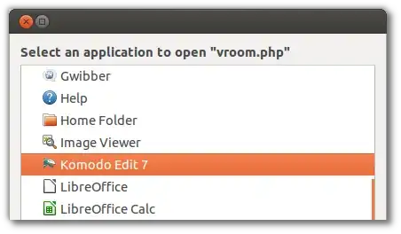

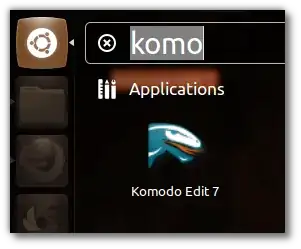

  4. Check that Komodo Edit shows up in the Dash (it may take a few moments):
  5. Now, it should also show in the Other Applications list for php (and other) files:
