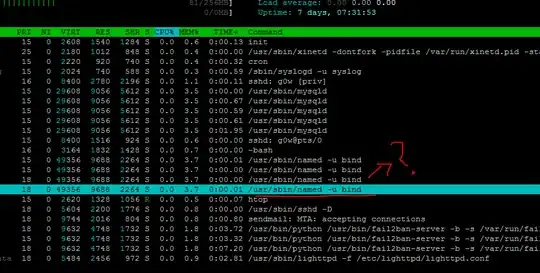

I want to know why the named daemon is running, do I need it running for my VPS to work properly ?
Can I stop or remove it ?
