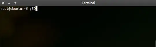

if I remove /etc/inputrc, here's what I get if I hold CTRL then press right arrow five times: pressing ctrl+right arrow
Unlike the first image above, holding CTRL and pressing left arrow more than once will not print out ;5D again... it's like it's accepting the command once and doesn't do it anymore .. see below image: pressing ctrl+left arrow
