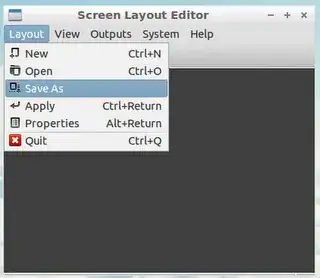

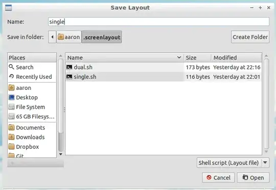

Although you haven't really done anything at this point, save this configuration.
It will automatically create a new hidden folder called .screenlayout in your home directory. I would encourage you to not change the file location to help with later steps. I would also encourage you to use my file names as well. This one should be called single.

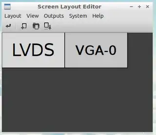

Now add your second monitor. It should be hooked up to your computer at this point, of course. I added mine by scrolling through the only other monitors that allowed activation and selected it.
Position the monitors however you like. I prefer side-by-side, but you may also put one above the other. It doesn't matter which one is on the left (or the top). It's all up to you! Here's what I like:
Once you have your desired configuration, save it again. This time, name the file dual.

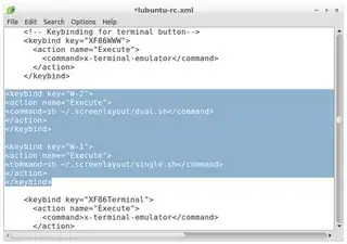

Scroll down to a place where you begin to see a lot of words that say <keybind>. You don't need to know what's happening here. Simply find a place after a </keybind>, but before the next <keybind> and paste the following:
<keybind key="W-2">
<action name="Execute">
<command>sh ~/.screenlayout/dual.sh</command>
</action>
</keybind>
<keybind key="W-1">
<command>sh ~/.screenlayout/single.sh</command>
</action>
</keybind>
Your code should look a little like this:
Save. Close. Logout.
If you did everything right, you should be able to press Super+2 to activate dual monitor mode. To go back to one monitor, such as your laptop, press Super+1.

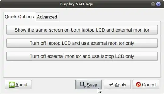

The idea is to use xrandr commands. But how to find the proper commands?
I have found a simple solution as a result of this answer.
Simpler, because involves using the LXDE default display manager, LXRandr, without the need of scripts.
It can save configurations (which are xrandr configurations).
When it saves the present configuration the older one is overwritten. But finding them and using them as shortcuts is a nice way to achieve what we want here.
The save is in ~/.config/autostart/lxrandr-autostart.desktop.
