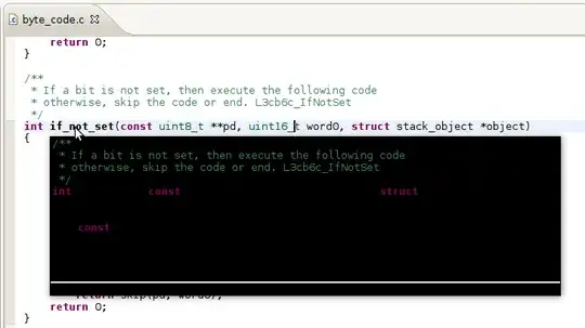

This is what a function tooltip looks like for Eclipse CDT in Ubuntu 10.04 with the default theme:
black is the new black!
There's nothing in Eclipse's General > Appearance > Colors And Fonts preferences settings. Is there an easy fix for these unreadable context sensitive help boxes?

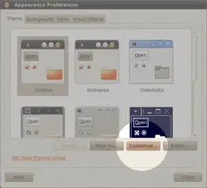

This can be solve by changing the background colour in Ubuntu. I’ve tried changing the background colour in Eclipse but it doesn’t seems to works. To change the background colour in Ubuntu, go to

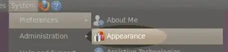

System > Preferences > Appearance
“Appearance Preferences” panel shows up, click on “Customize…”.
“Customize Theme” shows up, go to “Colors” and select a lighter color for “Tooltips” Background, a darker color for “Tooltips” Text.
Start or restart Eclipse, you will see the the lighter colors you selected when the code-assist appears.

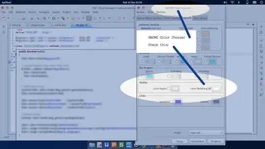

i think, the tool you want to install is Gnome Color Chooser
i have the screenshot here:
type this to install Gnome Color Chooser:
sudo apt-get install gnome-color-chooser
open it, and go to Spesific -> Tooltip - Background
choose your desired color, and apply it.
does not need to restart your eclipse, the tooltip background color is immediately changing.

Try to customize the used Ubuntu theme System > Preferences > Appearance > Customize In the tab Colors change the background and text colors of Tooltips
I had the same problem with Zend Studio, it seems that the only fix at the moment is to adjust the tooltip colors in the appearance settings for ubuntu.
