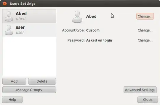

Go to the Unity dash, and type Users and Groups. When the window opens, click on the desired user, and then the Advanced Settings Tab
and then click on the User Privileges tab, and choose the options that you want.
