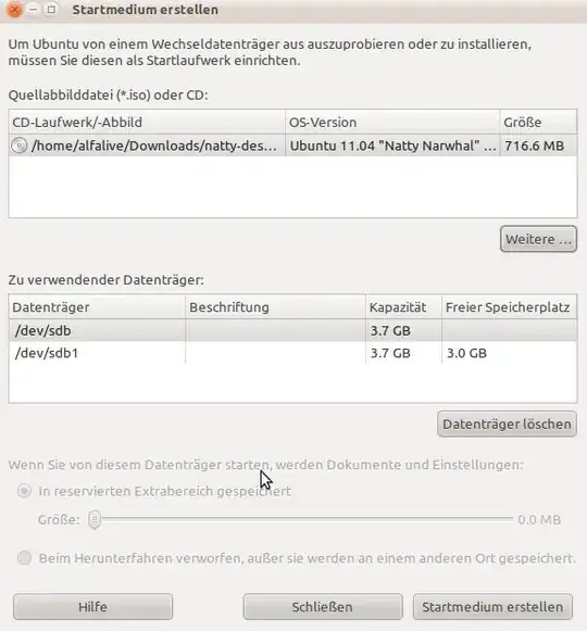

I try to test natty alpha with usb. (my system is 10.04) But when I run disk creator I can not choose the option for persistent creation. Here on screenshots I saw that this is possible. Choosing the second option "Burn your CD or create a USB drive"

I find the USB creator to be a bit buggy sometimes, but here's how it usually works for me:
  • Select /dev/sdb,
  • Click on 'Erase Disk > Yes' ('Datenträger Löschen > Ja'),
  • Wait a bit until that red exclamation mark next to '/dev/sdb1' disappears,
  • Select /dev/sdb1 - now you should be able to choose the amount of persistent space.
