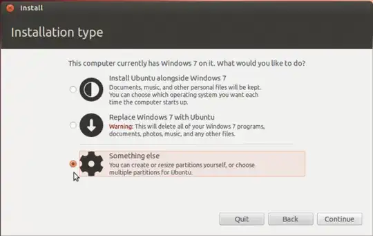

  2. Proceed with installation steps. Select the first default option Install Ubuntu alongside Windows 7 for ease of installation. (sorry for the wrong optioned screenshot).
Then at the Partition table, select the Free space or Unallocated space.
--Select the Add option and then allocate the desired Space for root / and swap partitions in ext4 format [search or refer to Ubuntu Guide for the minimum and your RAM based swap space requirement, or you can also select the Something else option for manual partitioning. If you want different partitions for /home, /boot, etc. you can allocate them in the same way.
-- Then select the appropriate drive at the Grub Bootloader Installation option, if there's only a single hard drive then most probably it will be sda . And it's done.
