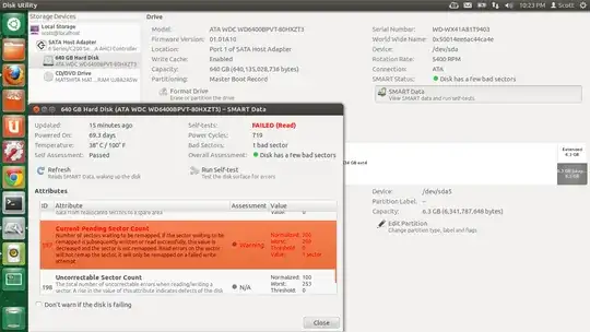

I have 12.04 32bit installed on my hard drive. Ubuntu is the only OS. I recently installed it after getting rid of Windows 7. When I run Disk Utility under SMART Status it says "disk has a few bad sectors", so I clicked on View SMART data and run self tests. I run the extended SMART self-test and it only takes 5-10 seconds for it to stop and reads Self-Tests: FAILED (Read), Bad Sectors: 1 bad sector, Overall Disk Assessment: Disk has a few bad sectors.
Is this something I should be worried about?

At this point in time I wouldn't. Hard Drive manufacturers, normally pack spare sectors in the drive just for situations like this. Keep an eye on it, and always have a backup of your data handy. Also I would suggest that you run the manufacturers diagnostic tool, and that can be acquired form the drive manufacturers website. Once you do that, and it gives you an error code, and providing htat the drive is still under warranty, then call the manufacturer,and get it replaced.
Important note to keep: Disks that start with 1 bad sector, will probably get worse. I can't stress enough the importance of a backup.
Mitch
  • 109,787
Be worried when "pending" bad sectors start showing up in SMART
Modern drives handle "simple" bad sectors automatically and transparently, by remapping them to one of the spare sectors allocated for this purpose without getting SMART's CURRENT_PENDING_SECTOR involved.
Once you see that value go above zero, it usually means one of two things:
  • The drive has (or will soon) run out of the spare sectors, leaving the "bad sector" marked as unusable
  • The bad sector was not "simple", and could not be read/corrected in the first place even if there were plenty of spare sectors left.
Either of those are not good for the future of your drive. You can check the exact errors by looking at the drive's internal log with smartmontools; use smartctl -l xerror /dev/sdN to get the extended error log (or -l error for the standard log).
If under warranty, and you have a spare drive/space to back the data up to, I would consider having this drive replaced ASAP.
