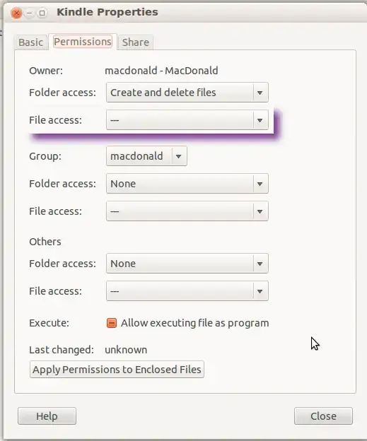

I have a funny thing happening with my USB devices. They are detected and show up as they should but I cannot write to them, I can read the files in them.
Read only
Cannot change option
I cannot change the Group folder access. It keeps reverting to none when I try change it.
However when I start a guest session and copy a screen shot to the USB I can, but cannot in my regular administration session. Why cannot I change the option and why does it behave properly in a guest session but not normally? Anyone know how to help me out here?
I am using Ubuntu 12.04, 32-bit.

Weird, I have what seems to be the same problem on my flash drive. Except I use the terminal commands [cp, rm, etc], and it says permission denied. However when I become root it works.
But for now, try this in a terminal:
$ gksu nautilus
Then try using that window to copy files. I believe you will find it does, because it's using root permissions. Be careful with that window, because you can remove system files, so I do not recommend using Nautilus as root normally, but in this case you might need to until you figure out how to fix the flash drive.
