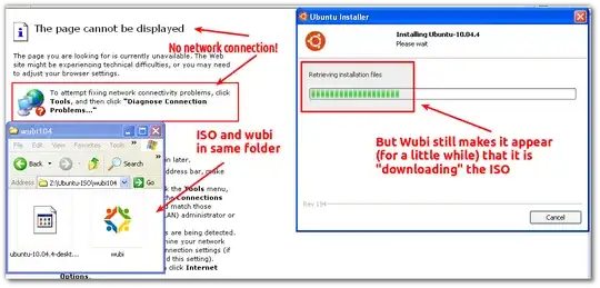

Illustration of the misleading "downloading/retrieving" issue:
ish
