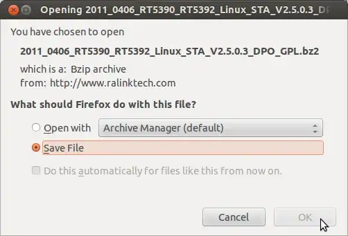

  • Your adapter has a Ralink RT2870 chipset. You can download the official Linux drivers from this site. Save them to your Downloads folder (default):

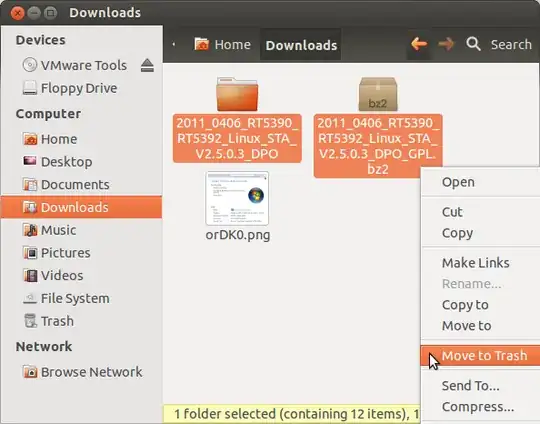

  • Then open up the Downloads folder in the File Manager and delete the downloaded Ralink file/folder.
