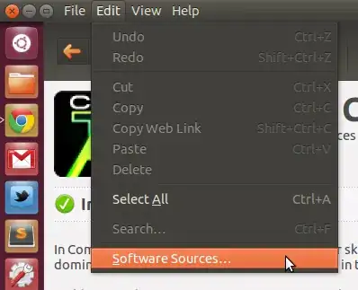

Launch the software center and select software sources:

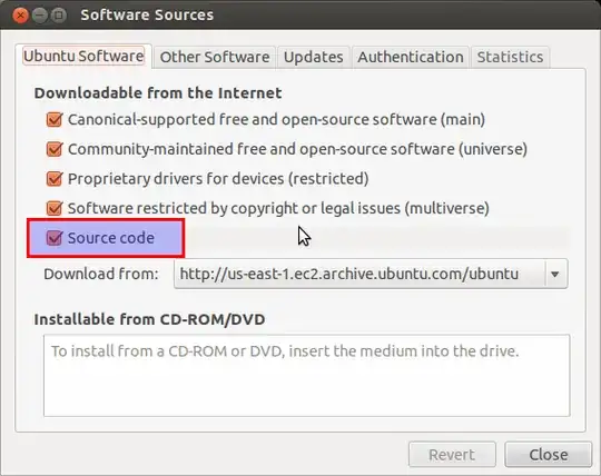

In the software sources make sure "Source Code" is checked:

To verify, you can check in the /etc/apt/sources.list file, and in the files in /etc/apt/sources.list.d/, to ensure the deb-src lines for each deb archive line, are there. Also, in the Software Sources properties dialog, you can check that the Source code option is checked on the Ubuntu Software tab, and that there are corresponding Source entries for the Binaries entries, in the list of additional sources under the Other Software tab.
