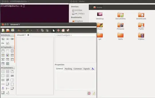

Now, in certain apps, I find white space between the window borders and content. Due to my limited English, I won't be able to properly describe what happened, so I guess I'm just going to show it using a screenshot.
It's like, nothing that bad. But it just looks so ugly.

I noticed that this, in contrast to what nils8950 said, only happens with GTK2 applications, not with GTK3 applications.
