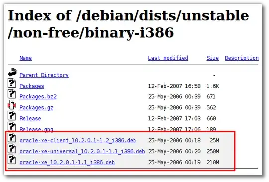

If you need the Oracle XE packages from that repository, simply installing them manually is the best option; they haven't been updated since 2006, so it's unlikely they will ever be.
  1. Go to https://oss.oracle.com/debian/dists/unstable/non-free/binary-i386/
  2. Download the .debs you need.
  3. Open in Software Center to install, or install from the terminal with sudo dpkg -i name-of-deb.
