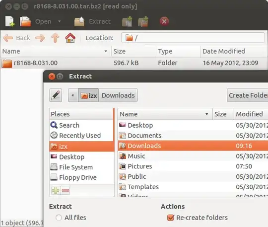

  1. Open the downloaded file in Archive Manager, and extract it, e.g to the Downloads folder as shown below:
  2. Open a terminal with Ctrl-Alt-T, and change to that directory, e.g. cd Downloads/r8168-8.031.00
  3. Type sudo ./autorun.sh and that should take care of removing the old driver and installing the new one.
