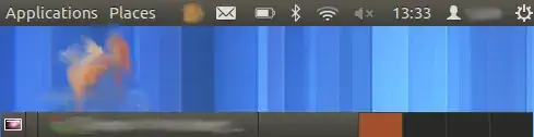

I've installed Gnome 3 by running sudo apt-get install gnome on my netbook, it all installed fine and ran fine didn't have any issues with it for a few weeks, then I turned on my netbook and logged in to be given the look and feel of Gnome 2.
I've cropped down the desktop in the image below.
Gnome 3 Desktop

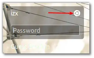

  3. Click on the Ubuntu logo:

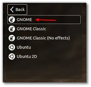

  4. Select the Gnome session, and click back:
  5. Login and see if you still get the Gnome2 look-and-feel.
