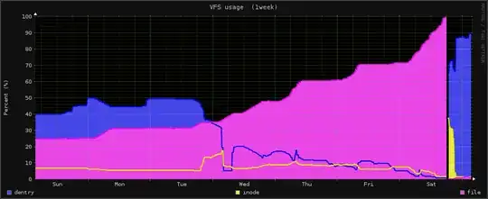

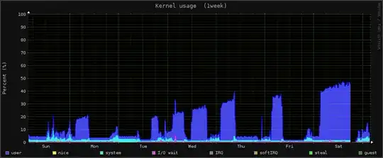

File System Usage for one week Kernel / CPU usage for one week
Edit: Just added two graphs from my monitoring system. Interesting to see: everytime when there's a "jump" in memory consumption, CPU peaks as well. Just found this right now -- and it reminds me of another indicator pointing to X itself: Often when returning to my machine and unlocking the screen, I found something doing heavvy work on my CPU. Checking with top, it always turned out to be /usr/bin/X :0 -auth /var/run/lightdm/root/:0 -nolisten tcp vt7 -novtswitch -background none.

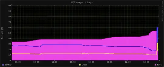

VFS usage (2 days)
See the drop of file handles at the end? That was the plasma restart.
