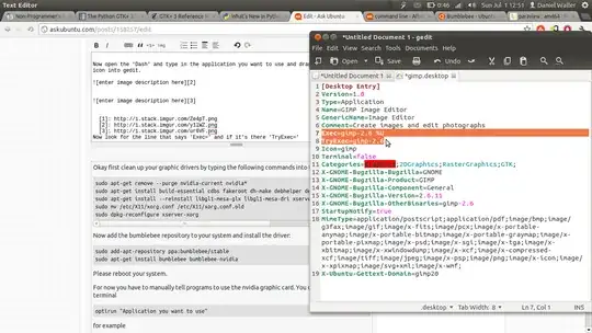

To start an application with optirun support everytime by just clicking on the launcher icon, do the following:
Start 'gedit' as super-user by pressing Alt+F2 and typing 'gksu gedit'

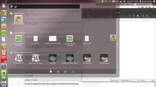

Now open the 'Dash' and type in the application you want to use and drag the launcher icon into gedit.

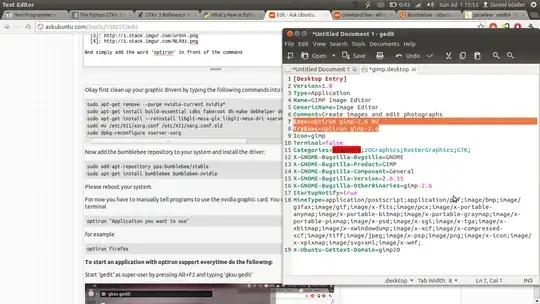

Now look for the line that says 'Exec=' and if it's there 'TryExec='
And simply add the word 'optirun' in front of the command
You will have to do these steps for every application with high graphics demand and I would recommend your browser as well in order to have proper hardware acceleration for HD Video on youtube.
