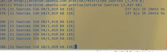

I am using Ubuntu 12.04. I am doing Internet with a USB Modem of 236kbps. My issue is that if I am accessing a web page through a browser it works, but if I am doing sudo apt-get update in a terminal, there is no response. Please help me to solve this.
One more thing; I am unable to change my DNS settings.
raja@badfox:~$ cat /etc/resolv.conf
# Dynamic resolv.conf(5) file for glibc resolver(3) generated by resolvconf(8)
#     DO NOT EDIT THIS FILE BY HAND -- YOUR CHANGES WILL BE OVERWRITTEN
nameserver 220.226.100.40
nameserver 220.226.6.104
nameserver 127.0.0.1
I want to replace these addresses with ones linked here http://www.cyberciti.biz/faq/free-dns-server/.
See the picture to have some idea about my issue .enter image description here

EDIT: This issue seems irrelevant to DNS server. According to your photo, it shows a slow download speed/ unstable connection, instead of high domain name resolution delay. Anyway, if you want to use another DNS server, consider OpenDNS. Also, the maximum transfer rate of your modem is 236kbps, i.e. 29.5KB per second. Don't expect a fast Internet connection.
